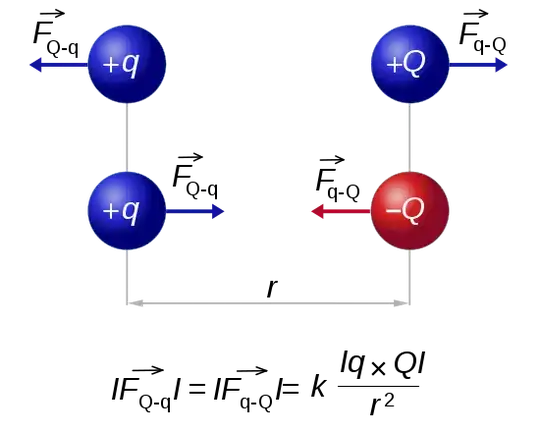

The magnitudes of both Coulomb's and Newton's laws are given by
$$ F_C = k\frac{Q q}{r^2} , \qquad F_N = \frac{G M m}{r^2}. $$
Now ask yourself what are these statements really telling you. In their current forms they are simply numbers or you could say both $F_C$ and $F_N$ in their current form are a measure of the strength of either attraction/repulsion between two charged particles or it measures the strength which two particles are gravitationally attracted to each other.
In what direction are these forces directed? This is answered by using a vector equation. Please see image below (kindly borrowed from Wikipedia.)
