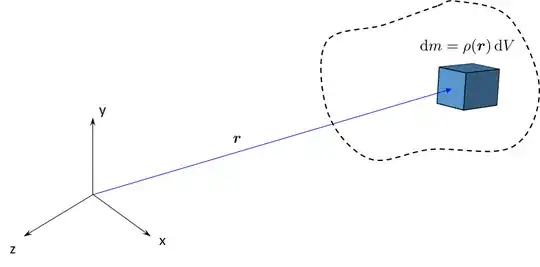

The division is done over the body (and its mass) in order to sum up all the effects needed.
It is not just a mathematical trick, but a physical measurement taken over the entirety of a body.
pic
The general rule is
$$ \text{(result)} = \iiint \text{(measurement)} \,{\rm d}V $$
as in mass, center of mass and mass moment of inertia.
$$ \begin{aligned} m & = \iiint \rho(\boldsymbol{r}) \,{\rm d}V \\ m \,\boldsymbol{r}_{\rm CM} & = \iiint \boldsymbol{r}\, \rho(\boldsymbol{r})\,{\rm d}V \\ \mathbf{I} & = \iiint \pmatrix{y^2+z^2 & -x y & -x z \\ -x y & x^2+z^2 & -y z \\ -x z & - y z & x^2+y^2} \rho(\boldsymbol{r})\,{\rm d}V \end{aligned} $$
