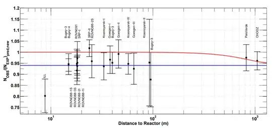

However, there are experiments that search for right-handed sterile neutrinos. Those that come to my mind are experiments investigating neutrino oscillations. During the investigation of the oscillation properties of neutrinos produced at nuclear reactors the so-called Reactor Antineutrino Anomaly (RAA) has been observed i.e. the measured neutrino flux in short distance to the reactors was lower than expected (if one assumes the usual oscillation of neutrinos between three flavors). Those "missing" neutrinos can be explained by the oscillation of reactor neutrinos into a fourth neutrino type. For more detail on the RAA see e.g. this link .
Short baseline neutrino oscillation Data
The red line in this graph shows the expected data for the usual 3 flavor oscillations. As you see the tendency of the neutrino events close to the reactor is to be lower than expected. However, this anomaly could in principle still be statistical. Experiments that want to further analyze this with respect to the possible existence of right-handed neutrinos are e.g. the STEREO experiment.
