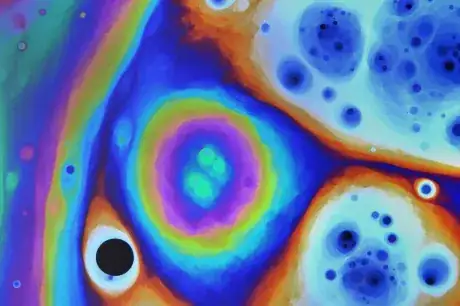

Here is a photo of a section of a soap film that shows constructive and destructive interference.
Soap film
High-contrast magnified-image of coloured interference-pattern in soap-film, (original area is approximately 10mm x 15mm). The black "holes" are areas where the film is very thin, (~10nm), and there is near-total destructive-interference, (hence they appear black).

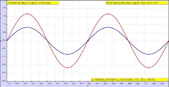

Here is what constructive interference looks like:
Constructive addition of waves.
