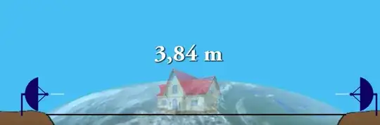

According to the experimenters, the curvature of the Earth over that distance, for an antenna 1 m above ground, would present an obstacle of 3.84 m. This should be sufficient to prevent the antennas from remaining in radio contact.
Illustration of curvature
The above image illustrates what is described above. (The house is in the image as an example of an object 3.84 m high.)

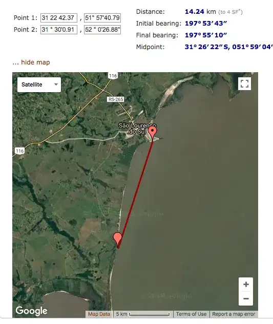

On their web site (which I've looked up since posting this question, to get more exacting details), they state the locations of the two antenna as:
Team A: São Lourenço do Sul, RS 31 ° 22'42.37 "S 51 ° 57'40.79" W
Team B: São Lourenço do Sul, RS 31 ° 30'0.91 "S 52 ° 0'26.88" W
I've checked, and the distance between those points is 14.24 km. I used this tool to check. Here is a screen shot of the result.
Screen shot of antenna locations
