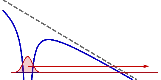

That picture is tunnel ionization. Since we're in a roughly adiabatic regime, where the suitable measure for $\omega$ (namely, $\gamma$) is small, then we can basically think of the interaction with the laser, the dipole coupling $$ \hat H_\mathrm{interaction} = e \hat{\mathbf r} \cdot \mathbf F(t) $$ as a time-dependent linear potential that gets added to the initial atomic potential well. And, if that field is strong enough, then it can bend the potential low enough to make a potential barrier that the electron can then tunnel through:
Image source
If you do the calculation for the rate of (quasi-static) tunnelling through that barrier, the core result is that the rate goes as $\omega_t = F/\kappa$ (or $\omega_t = eF/\sqrt{2I_pm_e}$ with all the constants put in), and this mechanism will only produce a sizeable tunnelled population if the field peak is sustained longer than that, i.e. if the Keldysh parameter $\gamma = \omega/\omega_t$ is small enough.
Thus far for tunnel ionization, which is relatively 'clean' as far as things go. Now, it should be clear from my diagram above that if you turn up the intensity even further (thereby taking you even further away from the validity of the photon picture) then at some point the peak of the tunnelling barrier will be so low that it falls below the energy level the electron was initially sitting on: this is the situation for Over-the-Barrier ionization, and it should be clear that it is swift and effective at removing the population from the bound state and onto the continuum.
