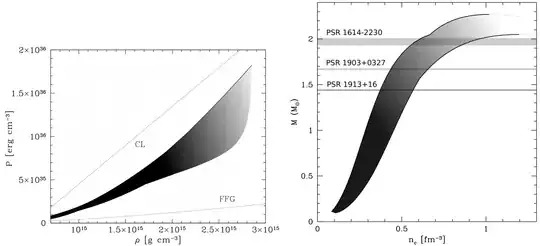

"The current lack of knowledge of the EoS and the corresponding uncertainties in the predicted NS masses are illustrated in Fig. 1.
Fig. 1. Left panel: range of equations of state of dense matter (pressure $P$ versus mass density $ρ$), as predicted by various models and consistent with the existence of massive neutron stars. The dotted lines labeled CL and FFG correspond to the causal limit and the free Fermi gas equations of state, respectively (see Sec. 4). Right panel: corresponding range of allowed masses $M$ for nonrotating neutron stars as a function of the central baryon number density $n_c$. The horizontal lines correspond to the precisely measured masses of three pulsars (see Sec. 6).".

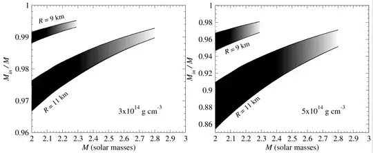

"Fig. 2. Fractional mass $M_{in}/M$ contained in the inner region of a static spherical NS of mass $M$ and radius $R$, at density $ρ > ρ_⋆$, for two different cases: $ρ_⋆ = 3 × 10^{14} \, g \, cm^{−3}$ (left) and $ρ_⋆ = 5 × 10^{14} \, g \, cm^{−3}$ (right). The shaded areas reflect the uncertainties in the EoS $^{28, 30}$ at $ρ < ρ_⋆$. Only the ranges of $M$ and $R$ allowed by the compactness constraint$^{16, 77}$ $r_g/R ≤ 6/8$ are shown. See the text for details.".

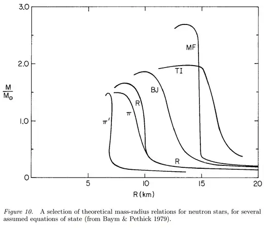

On page 26 is this useful diagram showing matter's aversion to forming certain sized masses. This text starts on page 25:
"... A few years later, McClintock & Remillard (1986) measured the mass function of the transient source A 0620–00 (which also had a very soft X-ray spectrum during its outburst in 1975) after it had returned to quiescence, to be 3.18±0.16 M$_\odot$.
This immediately (see below) showed that the compact star in this system is too massive to be a neutron star, and gave some confidence in the idea that X-ray spectra may be an efficient way to select BHXBs.
In spite of the fact that some X-ray spectral characteristics of black holes, and rapid variability are also seen in some neutron stars, their combined presence, in particular in X-ray transients, has remained strikingly effective in singling out black holes.
As implied in the above discussion, the main argument that the compact object in a particular X-ray binary is a black hole, is that neutron star masses cannot exceed a certain maximum value. This assumption rests on very general considerations, e.g., that sound cannot travel faster than light, on the basis of which Nauenberg & Chapline (1973) and Rhoades & Ruffini (1974) concluded that any neutron star, independent of the equation of state (EOS) of high-density matter, must have a mass $\small{\lesssim}$ 3 M$_\odot$. Rotation of the neutron star (ignored in the above analyses) does not increase the mass limit by more than 20% (Shapiro & Teukolsky 1983). Detailed modelling of neutron stars, for a wide range of equations of state, leads (see Fig. 10) to upper mass limits between ∼ 1.5 M$_\odot\!$ (very soft EOS) and ∼ 2 M$_\odot\!$ (very stiff EOS) (see, e.g., Arnett & Bowers 1977; Datta 1988; Cheng et al. 1993; Cook et al. 1994; Engvik et al. 1996; see also the contribution of N. Glendenning to this Volume).
The fact that compact objects with dynamical mass estimates exceeding
∼ 3 M$_\odot\!$ cannot be neutron stars, is not equivalent to their being black holes, as defined by the particular space-time structure described by Schwarzschild and Kerr metrics, which are characterized, in particular, by the absence of a hard surface. This has led to the extensive use of the term “black-hole candidate” for these objects. Of course, detection of X-ray pulsations or X-ray bursts immediately disqualifies a compact star as a black hole, but positive evidence for the absence of a hard surface has been very hard to obtain. This should not come as a surprise, since a nominal (M = 1.4 M$_\odot$, R = 10 km) neutron star is just 2.5 times larger than its Schwarzschild radius, and one may expect the accretion flow to be very similar to that of a black hole of comparable mass. The energy release at the neutron star surface, which is absent for a black hole, might lead to observable differences in spectra and variability, but unless the origin of the spectra and variability of X-ray binaries is much better understood than it is nowadays, the conclusion that a black hole has been found on the basis of such phenomena must be considered weak at best.".
[The authors refer again to Figure 10 much later, on page 41.]
