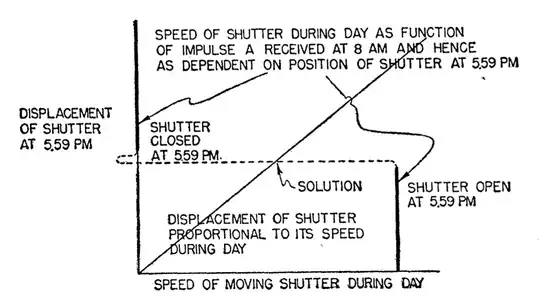

To resolve, we divide the problem into two parts: effect of past of $a$ upon its future, and of future upon past. The two corresponding curves in Fig. 2 do not cross. We have no solution, because the action of the shutter on the pellet, of the future on the past, has been assumed discontinuous in character.
enter image description here Fig. 2. Analysis and resolution of the paradox of advanced effects. The action of the shutter on the pellet—the interaction of past and future — is continuous (dashed line in diagram) and the curves of action and reaction cross. See text for physical description of solution.

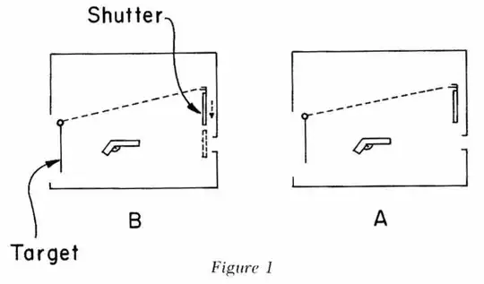

To see how this is so, consider the case already cited of a person who meets his former self in circumstances in which, if physics were normal, he would be able to shoot him. Then, as a preliminary step in the analysis, let us replace the complex human being by a simple automaton which nonetheless exhibits the abnormal physics referred to. This apparatus is to consist of a gun, a target, and a shutter so arranged that the impact of a bullet on the target will trigger the shutter so as to move in front of the gun. It pursues a causality-violating curve in spacetime in such a way that two points on the object's world line $A$ and $B$, with $B$ later in the object's history than $A$, are physically contemporaneous and disposed as in Figure 1 so that the gun at $B$ is aimed at the target at $A$ and the shutter is initially up at $A$.
Suppose now that the machine "shoots its former self" : the gun at $B$ is fired, either by an automatic timing mechanism or by the intervention of a human being making a conscious decision. If the shutter in $B$ were still up, the bullet would strike the target at $A$, which would cause the shutter in $B$ to be down, a contradiction. But if the shutter were down in $B$, then the bullet would be stopped, the target $A$ would not be hit, and the shutter in $B$ should still be up: the shutter is up if, and only if, it is down; the situation is logically impossible.

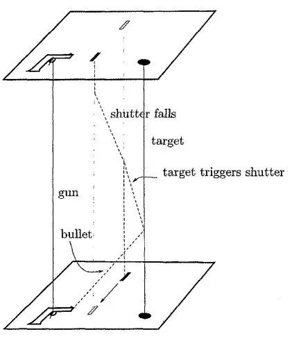

At a first glance, the possibility of "free will" seems to be at the center of the issue. However, following (Wheeler and Feynman 1949) Clarke (1977) has re-formulated the thought experiment in terms of a simple machine and has argued that the thought experiment is fallacious : Assume that there is a gun directed at a target in spacetime. This target is connected with a shutter which, if closed, blocks off the path between the gun and the target : If the gun is triggered, the bullet will hit the target which in turn will cause the shutter to fall. A second shot will now be blocked by the shutter and therefore cannot hit the target (c.f. Fig. 8.1.3). Now assume that the configuration is located in a region with causality violation such that the shutter falls along a closed timelike curve so that it blocks the bullet before the gun has been triggered. Again we seem to arrive at a contradiction : If the shutter is open the bullet can hit the target. But the target closes the shutter which in turn blocks the path of the bullet.

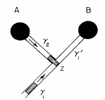

First, a system of tubes connected to the wormhole, such that a piston may travel back and block itself from going forward. Due to the lack of freedom to move sideways, this one does contain initial conditions where there is no consistent development.

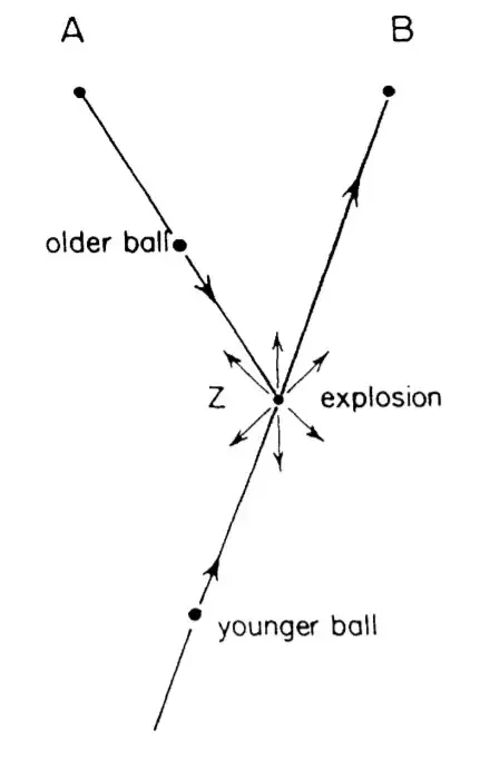

Then, to avoid any issue of the past object replacing the future object, he also considered a few bomb-related systems. The first system is a ball rigged to explode when touching any other object.
The initial data are arranged in such a way that the ball enters mouth $B$, emerges from mouth $A$ in the past, continues the motion and arrives at the point $Z$ just in time to collide with the "younger" version itself. This encounter leads to the explosion. We did not take into account the influence of the future on the past before the ball entered the mouth $B$, and this is the reason for the "paradox."

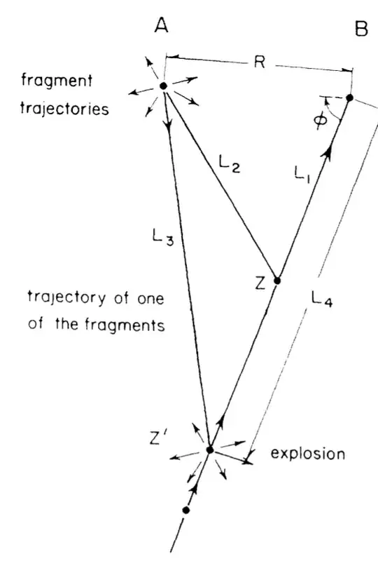

But there is a self-consistent evolution, as shown in Fig. 6. The initial data are the same as in Fig. 5, but before reaching the point Z it meets the fragment of the explosion of itself. This fragment hits the ball and it is the cause of the explosion, the fragments of the ball fly in all directions with velocities much larger than the velocity of the ball. Some of them fly into mouth Band emerge from mouth $A$ in the past. One can show that they will continue to fly in practically all directions from mouth A, because they have different impact parameters when they few into mouth $B$. One of the fragments from mouth $A$ crosses the trajectory of the ball at the point $Z'$ exactly at that moment when the ball arrives at the same point $Z'$. This fragment is the cause of the explosion of the ball. The consequence of the explosion (the fragment) is the cause of the explosion.
