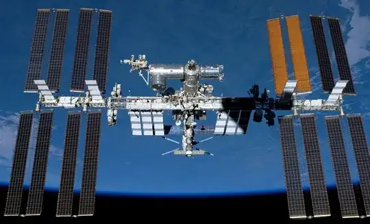

Generally, this is a slow process. Efficient cooling of space ships for example require large surfaces. For example on the ISS, some of those large panels are actually there to radiate energy away to cool the space station. The zig-zag panels in the middle of the picture are part of the External Active Thermal Control System and are not solar panels.
