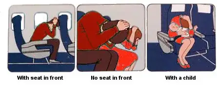

enter image description here (source)
Assuming the brace position minimizes the chance that you'll be injured or killed by whiplash or by striking nearby seats, passengers, or other equipment.
If the plane crashes like the one in New York, then you should listen to the safety lecture before takeoff and follow the on-board safety instructions. If the plane crashes like the one in Afghanistan, then it doesn't really matter what you do.
