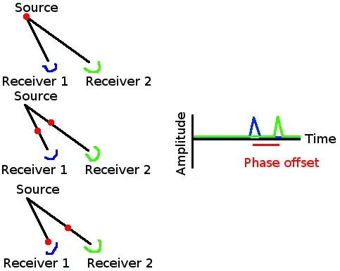

Jon Custer gave a correct technical overview; I'll have a go at a bare-bones conceptual description. The idea is to record the amplitude at each receiver in the array at a series of times, and then to offset the signals from the different receivers in time and look for a correlated signal. From the offset applied to get a correlated signal you can use simple geometry to get the angle to the source. I'll walk through it with a diagram:
On the left I show three time snapshots of a source emitting some signal (red dot). The source is a bit further from receiver 2 (green) than receiver 1 (blue), so the signal arrives a little bit later at R2. This is shown in the amplitude-time graph on the right. If the blue curve is offset to the right it will eventually overlap with the green curve, which would show up as a strongly correlated signal. The phase offset is, in other words, the time delay between the arrival of the signal at the two detectors. The time delay multiplied by the speed of light is the difference in the distances to the source seen by the two receivers. If this difference is zero then the source must be directly "above" and between the two detectors; the larger the difference, the larger the angle from this reference direction to the source.
Scale this up to more receivers spread out in two dimensions and you can locate a source on the sky. Of course there are some "technical details" which make this a bit harder to actually implement, but the principle is basically as above.
