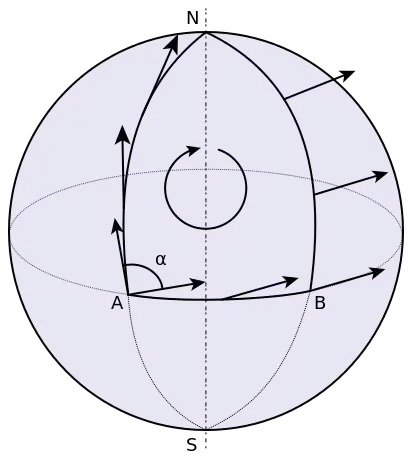

This is a nice illustration demonstrating this, taken from the wikipedia article on parallel transport.
All the fields in the picture are parallel to the curve they are on. The curve AN is a geodesic, and the velocity of it is indeed parallel to the curve (as it must be by the geodesic equation). The other fields are parallel transported, but are not velocity fields of the curve they are on.
