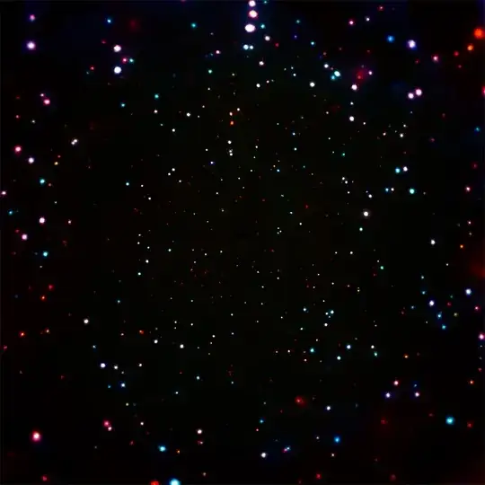

The false color image shown below was captured by the Chandra X-ray Observatory. The colors in the image correspond to three different X-ray frequencies.
Portion of the Chandra Deep Field-South, with different wavelengths of X-rays colored red, green, and blue
This image is from the Chandra Deep Field-South and represents over 7 million seconds (over 81 days) of cumulative observing time by Chandra. This patch of sky contains no nearby objects. The objects in this image are 9 to 11 billion light years away. (Better: The X-rays from those sources traveled for 9 to 11 billion before being detected by Chandra.)

That said, since even the most non-isotropic of sources will still have a nonzero beam width. Even at the center of the beam, the radiation should fall with the square of distance (in the far field). Some of the faintest sources in the above image represent about one photon being captured per every four days. That's why it took over seven million seconds of cumulative operation to build up the above image.
So yes, the flux from very remote sources can be rather faint. That doesn't mean it's undetectable.
