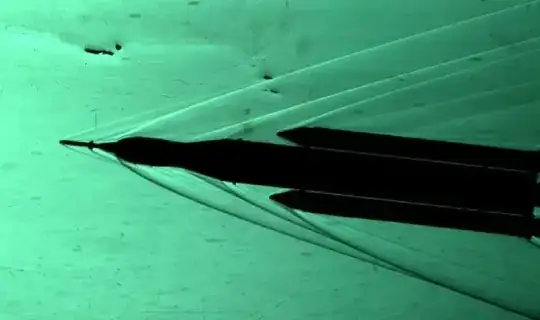

Although air is almost perfectly transparent, it can still cast shadows via refraction. The key principle regarding refraction is that light is bent when the index of refraction differs from one location to the next. Air and glass are different materials and have different indices of refraction. Light therefore bends when it goes from air into glass, such as at the surface of a glass lens. Refraction does not happen inside a glass lens because the material inside the lens is uniform. Refraction happens at the surface of a glass lens because that is the only place where the index of refraction differs. Uniform air itself cannot refract light and create shadows because the index of refraction does not differ anywhere. But, when different regions of air have different indices of refraction, the air can indeed bend light away from the forward direction and create a shadow.
The most common way to get a changing index of refraction in different regions of air is to heat the air. As air heats up, it expands and its index of refraction changes. A pocket of warm air sitting next to a pocket of cold air will therefore constitute regions with different indices of refraction. The interface between the cold air and the warm air will therefore bend light and cause shadows. This effect is most visible when strong direct sunlight is coming in sideways through a window, passes through cold ambient air and then passes through the hot air above a heater. The shadow that this air system creates on the far wall consists of waving, rolling lines mimicking the turbulent motion of the hot air as it rises.
The index of refraction of air also changes as the pressure and composition changes, therefore these effects can also lead to air shadows. For instance, the pressure variations caused by a plane plowing through the air can cause shadows. Also, gases being vented into ambient air creates spatial variations in the air, and therefore shadow-causing variations in the index of refraction.
The ability of non-uniform air to create shadows is used to great advantage in the imaging technique known as schlieren photography. In schlieren photography, the shadows are used to accurately map out the variations in the air. enter image description here
