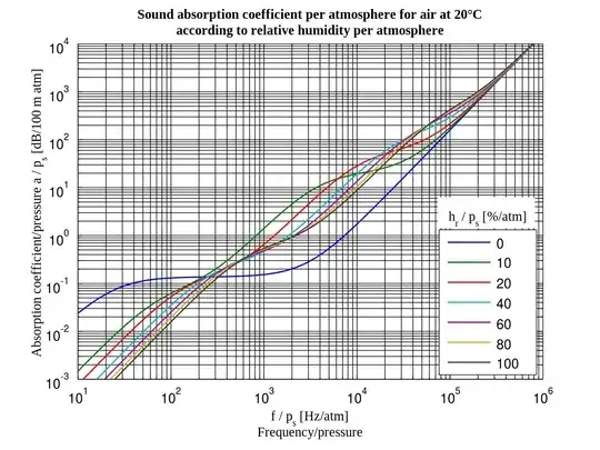

To take account of the attenuation in air you can consult this graph from https://en.m.wikibooks.org/wiki/Engineering_Acoustics/Outdoor_Sound_Propagation#/media/File%3AAtmospheric_sound_absorption_coefficient_2.svg
It shows very low attenuation at low frequencies, especially in dry air. With 0.1 dB per 100 m, you would lose another 5 dB at 5 km )roughly 3 miles), which is not very much. So the roar of the Harley, with lots of low frequencies, really does carry.
