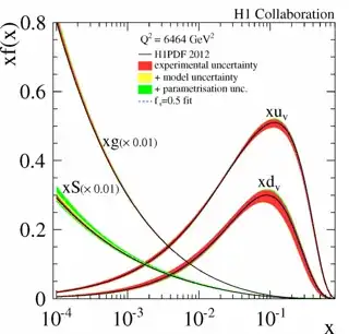

The parton distribution functions of the constituents have been measured in many experiments , example, :
partondist
Parton distribution functions in the proton extracted from the H1 data. The gluon g and sea S distributions are scaled by a factor 0.01. The uncertainties include experimental (inner) and model (middle) uncertainties and the parametrization variations (outer).
and confirm the QCD structure, and yes, depending on the energy transfer there can be an infinity of quark antiquark and gluons in the proton (hadrons generally) . This is now.
