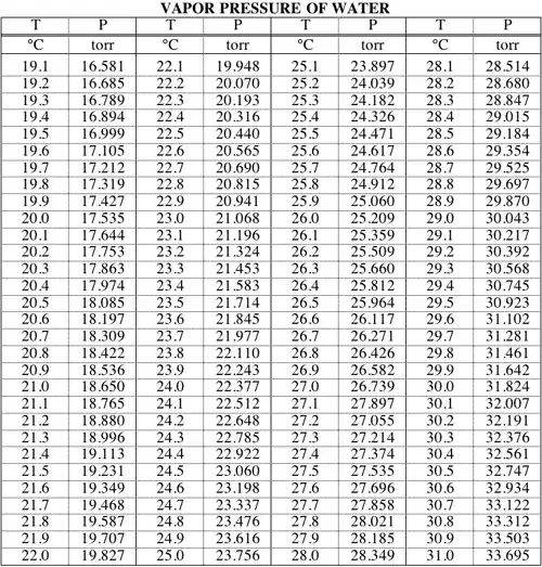

Since boiling, by definition, occurs when a liquid's vapor pressure reaches ambient pressure, your question is identical to asking what the vapor pressure of water is at room temperature. Here's an example of an online table:
At 23°C, for example, water would boil at a pressure of about 21.1 torr, or about a fortieth of atmospheric pressure.
