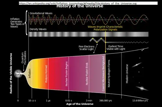

histuniv
The currentBig Bang.model with accelerated expansion,seen in the changing opening angle.
This accelerated expansion of the universe also does not expand bound states, as atoms, molecules , cups and tables, planetary systems, galaxies or even cluster of galaxies,bound systems.
The expansion of space does not take place on bound systems , because ,as a force, accelerated expansion is very very very weak. Even weaker than gravity.
