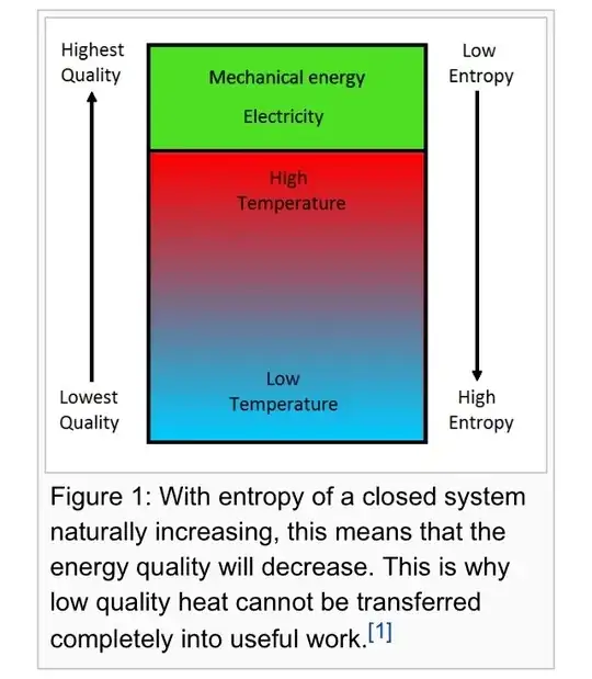

Here’s the picture they have:
Which made sense to me because at lower temperatures energy is much more “spread” and not so “concentrated”.

The website you consulted seems, to me, very confused and confusing, or it's simplifying things to the point of making wrong statements.
