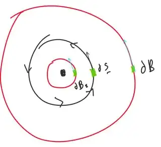

Perhaps this is possible, but I may or not understand why. If it's why, I'll illustrate why with a (poorly) drawn graphic I just made:
Where the red circles are lines of constant magnetic field strength and the black circle is the Amperian loop. As the loop is traversed, with each path element $d\vec S$, located at some value $\theta$ around the loop, the magnetic field vectors of all the magnetic field strength rings will be parallel to them since the Amperian loop is a circle. This would explain the need for an Amperian loop aligned this way in order to work out.
If this isn't the case, please clarify what is. If this makes some sense, some questions:
  • What happens if we don't use a circular Amperian loop? Could we accurately find the magnetic field? It would seem weird if we had to choose the correct loop shape
  • How do I know that $d\vec B$ in my graphic isn't going to be anti-parallel to $d\vec S$ at all points, rather than parallel?

What's cool about Ampere's Law is that it doesn't matter what the shape of the loop is: it will hold true even if you choose a funny-shaped loop (or if your magnetic field is more complicated). Now that might make the integration impossibly difficult for you to actually do, but it doesn't change the fact that the stated law is correct for any loop you could draw. The simplification you made was possible because you exploited the symmetry in that specific configuration. In most realistic situations, no such exactly correct simplification can be made. An approximation or a different approach might be required.
If the magnetic field opposes the sense in which you traverse the loop, the integral will give a negative result. This indicates that the current is negative (flowing in the opposite direction).
For an infinite wire we know that the magnetic field is circumferential everywhere. Another way to look at this is to see it as rotational symmetry about the circumference of the wire. From this, we know that the field only changes with changing distance from the wire and us independent of the angular position around the loop.
Due to this, it is convenient to choose a circular Amperian loop because the field is constant at each point so we can pull B outside the integral on the LHS.
Now Amper's law is always true regardless of the shape of the loop you choose. But if the field varies around the loop then we must actually evaluate the line integral which means we can't easily use it as a tool to find B.
Like Gauss law, it is a very powerful tool but only useful to find the field easily if we have some type of symmetry.
