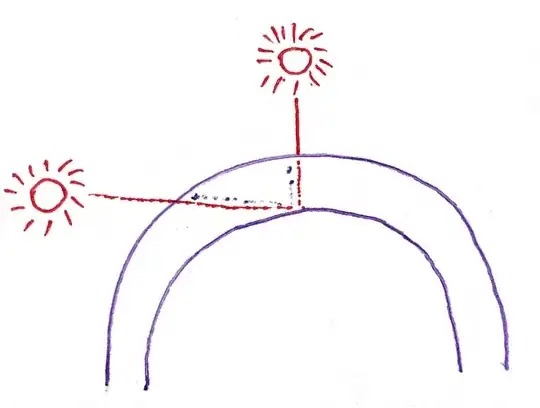

like the fact that when the sun is lower in the sky the radiation is traveling through much more atmosphere before it gets to me
Has place, of course. In astronomy, this is called "Air Mass".
This gorgeous pic will illustrate it (with a certain degree of exaggeration of the actual angle with the normal vector for the Earth surface)
Note: Skip to the end of the answer to see the actual data

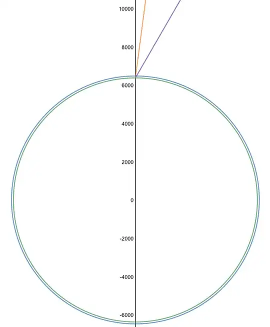

The data is: in the summer the sun was 7.5 degrees from overhead and in the winter the sun was 30 degrees from overhead. Here's how it would look:

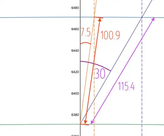

Now let's apply 200x scale and do the analysis:
The ratio would be: $\dfrac{115.4}{100.9}=1.144$.
That means, in the winter sun the radiation is going a path longer by 14.4%.
