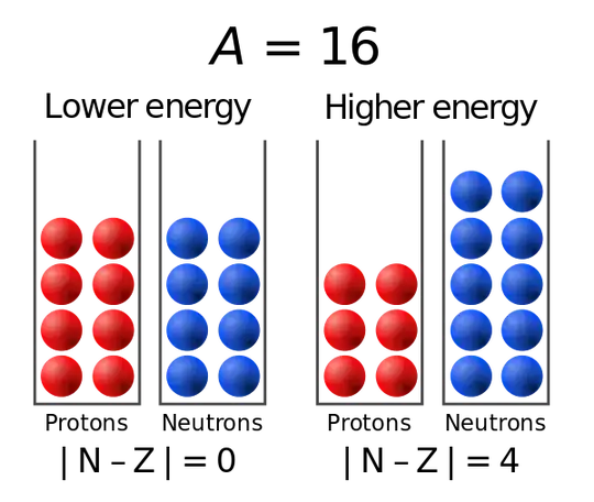

  • The fourth is the asymmetry term, which is minimized when the number of protons and neutrons is equal. The theoretical motivation for this term is the Pauli exclusion principle - because no two protons (resp. neutrons) can occupy the same state, adding additional protons (resp. neutrons) to a nucleus necessarily means that the latter will exist in significantly higher energy states.

In the context of this model, your question is answered by the asymmetry term. An excess of neutrons causes the neutron Fermi level to be too high - the nucleus would be more stable if some of extra neutrons underwent beta decay and became protons, so generically this is what happens.
