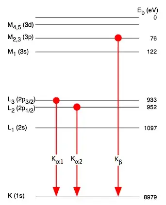

The basic reason is the multiplicities of the L-shell levels $2p_{3/2}$ and $2p_{1/2}$ that the K-shell hole makes a transition to. There are four states with $j=3/2$ ($m_j= -3/2, -1/2, 1/2, 3/2$) and only two with $j=1/2$ ($m_j=\pm 1/2$). So the intensity ratio is expected to be $2 : 1$.
And since you asked specifically about copper, I include a level diagram with the transitions:
