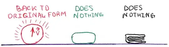

If all the above steps are passed, the object has to "un-deform" - internal energy gained because of deforming and not lost in the step 3 is turning back into the kinetic energy. Now it has its kinetic energy back, and thus has the speed to go up again.
In order to bounce, an object must "pass" all the steps above.
In other words, the objects bounces, if there is deformation and it's elastic, not plastic or viscous and most of the elastic potential energy is realised into acceleration of the whole object in the opposite direction.

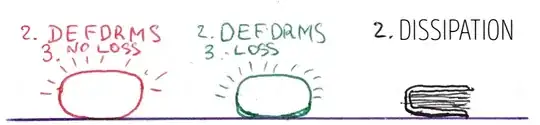

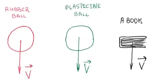

Let's see consider three different objects - a rubber ball, a plasticine ball and a book, and see how they behave.
Well, any of them can pass the first step since they have got the speed. Now they will fall on the ground.
Balls pass the second step, they deform to a different degree. A book primarily fails to bounce because its shape favours other modes of energy propagation - dissipation via vibration. Thus, the book is not a contender anymore.
What about the third step? The plasticine ball fails it - its gained internal energy was mostly lost because of being transformed into thermal energy.
So, out of three objects, only the rubber ball will bounce.
