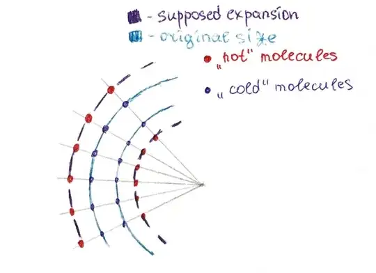

Let's suppose that the inner radius is actually becoming smaller.
This would mean that the molecules on the inner radius would have to be "packed" closer.
(also applies to any molecules that reside on the radius smaller than $\dfrac{R_1 + R_2}{2}$)
But then it would contradict with the fact the metal is expanding. Hence the inner radius will have to remain at least of its initial size.
Below is the pic of the expansion you suppose to happen (it won't happen this way, for the reasons described above).
