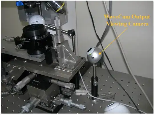

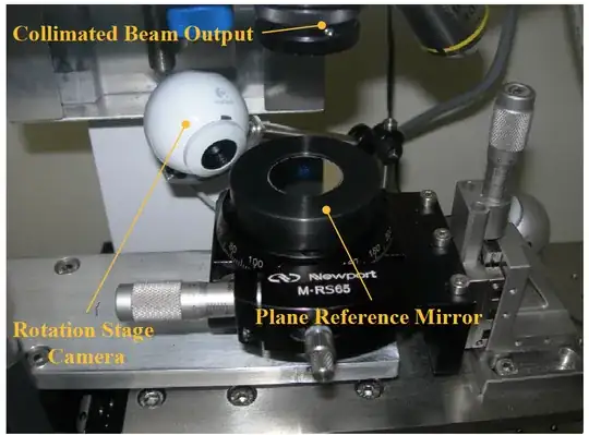

Below are some shots of webcam arrangements I have used in the past. You need either to get a friendly machinist to make brackets for you to attach them to the various Newport/ Thorlabs/ Edmund /.... stages and supports and allow them to swivvel so that you can adjust their view easily. It's easy to screw directly into the webcam's plastic housing. You should get some ideas from the below.
enter image description here enter image description here enter image description here

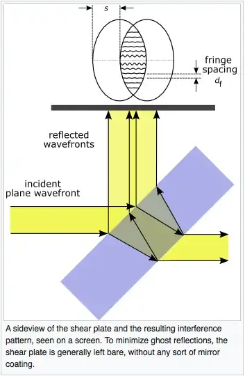

You can make your own shearing interferometer from a microscope slide but the easiest ones to use have a wedged shearplate so you're probably going to have to buy one for the reasons I discuss below. A diagram from the wikipedia page I linked is below
so that the device is creating interference between the two Fresnel reflected beams from either side of a parallel plate. The device is basically plotting a fringe pattern for the phase map $\Delta\,\nabla_\vec{n} \varphi$ where $\varphi$ is the phase field in the incoming beam, $\Delta$ the magnitude and $\vec{n}$ the direction of the displacement between the two beams. Converging/ diverging beams have, to lowest order:

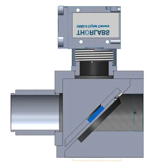

Here is a cross section of a setup I have used with a camera, whowing the relative positions. The tested beam comes in through the enclosed tube from the left and there is a beam stop on the right.

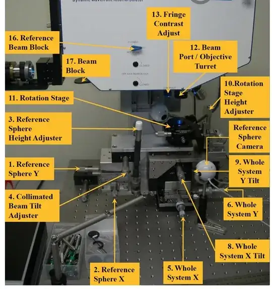

Beam quality - lack of aberration - is ideally assessed by a point diffraction interferometer. Here's my own writeup based on a commercial device here. This is a device that uses a pinhole to create a reference beam from the input beam, and thus can measure wavefront aberration of a laser beam.
An interferometer is a bulky and awkward instrument to get into a system, so you may be tempted to use a Hartmann wavefront sensor; see also the Wiki page here. In my experience, although they require little experience to use, one can get a much more accurate confirmation of low aberration with the Astronomer's Star Test and you need only a CCD screen, a focussing lens and your brain to do it.
