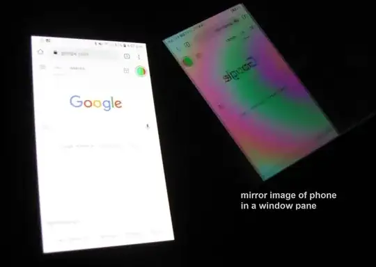

enter image description here Purple and green colors in mirror image of phone in a window pane, as seen with with naked eye.

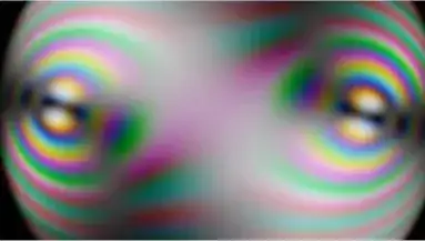

If you would like to test it on your phone, open an app that displays a white screen, and try to view the screen from very close to the screen, at a distance of just a few centimeters (the closer the better), while wearing polarizing glasses. As you already saw purple and green colors in a reflection of your phone screen, you will probably see an interference pattern like the photo below. It is characteristic for a biaxial birefringent layer. The colored fringes are called isochromes. The two bullseyes are the two axes of the birefringent layer.
Colorful bullseyes pattern, due to a biaxial birefringent layer in the screen of a laptop, seen through polarizing glasses from very nearby. Characteristic purple and green colors.

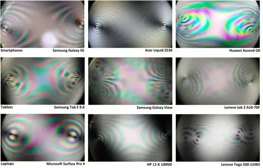

enter image description here The bullseyes pattern can be seen on many devices, like these 3 smartphones, 3 tablets and 3 laptops. Photos from a few years ago.
Some phone/tablet/laptop screens have the birefringent layer; others don't, like Iphones and Ipads. My experience is that whenever the reflection of the screen in a window has these purple and green colors, those colors can be seen even better through polarizing glasses. To see the complete pattern, with both bullseyes and the isochromes, the field of view must be more than 90 degrees. Therefore the best point of view is very close to the screen.

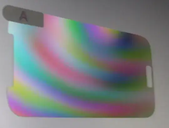

A related observation: take a laptop with a linearly polarised LCD screen. Cover a part of the screen with a "screen protector" (crystal clear laminated safety glass) for phones. When looking at the screen through polarizing glasses, the bullseye pattern appears on the screen protector, and not on the rest of the laptop screen.
