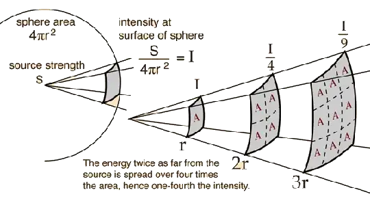

Point sources obey the inverse square law:
point source
and at astronomical distances the energy dispersion of the incoherent light from a sun can be approximated by this formula.
So by your mirror, you are generating a secondary (reflecting) point source there. The energy it reflects will be at astronomical distances also a point source, depending on the energy content the area of the mirror caught, which depends on geometry and the inverse square law to be calculated.
Note the term incoherent. Laser light is coherent, i.e. the phase relationships are stable for a certain distance and do not obey the inverse square law. Even for lasers there is a distance , which when exceeded the beam starts diverging, the power loss again obeying the inverse square law. See the answer here .
$1.96×10^7$ Compared to the point source multiplier ($0.25$), it is easy to see why a laser spot is much more intense for the same amount of power. It is not because lasers don't follow the inverse square law. It is because the beam's directionality gives it a huge initial boost in intensity, after which it proceeds to fall off as the inverse of distance squared.
