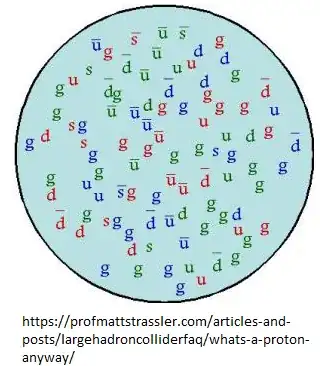

Here is an illustration that describes what is happening within the composite proton:
myproton
Quarks and antiquarks and gluons dance around and annihilate and pair produce in a non stop manner, so they do "overlap" in the feynman diagrams of the individual interactions, and annihilate. The three valence quarks are lost in the soup, and in any case it is a matter of conservation of quantum numbers, there should be an excess of one down and two up for the proton.
So it is not a matter of repelling, it is just that overall the quarkness up and down should add up to the valence quarks of a proton, and the same holds for the neutron two down one up excess in the soup .

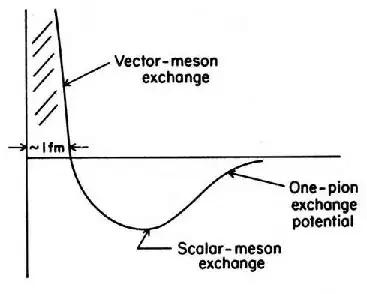

  2. The force that holds nucleons together is described by the nucleon-nucleon (NN) potential, which looks like this (horizontal axis is $r$, vertical axis is $V$):
The NN potential is a residual interaction resulting from very long-range reactions between quarks in adjacent nucleons. Since the reaction is long-range, color charge (and therefore gluons) cannot be exchanged. As such, the mediators for this force are color-neutral, and consist of the lighter mesons (like $\pi$, $\rho$, and $\sigma$). Because of this, the nature of this residual interaction is completely different from the quark-level strong interaction. In particular, note the strong repulsion that happens at distances less than 1 fm (i.e. the diameter of a nucleon). This repulsion, mediated by vector-meson ($\rho$) exchange, is what keeps protons and neutrons apart.
