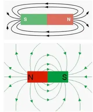

(c) This image again contradicts my interpretation of Magnetic Dipole Moment.

The last sentence is a simplification, and not very helpful one I think. A permanent magnet has a magnetic dipole moment due to the permanent alignment of the magnetic dipole moments of the involved subatomic particles (mostly electrons). Now imagine that you have two bar magnets with the same number of aligned electrons, one of them thin and long and the other bolt and short. Observing their field lines one can see that from the bold magnet nearly all field lines emerge from the end surfaces. From a thin and long bar magnet a lot of field lines emerge from the cylindrical surface.
enter image description here On the sketches the first shows how field lines are going for a bold and short magnet, the second sketch shows that for a thin and long magnet.
This has to do with the magnetic saturation of the material and this saturation has to do with the availability of alignable subatomic particles.
