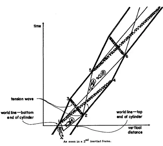

Second the solution I found states that the center of the cylinder(which is at rest in the inertial frame of the cylinder) does not jerk back and forth in any other inertial frame. However, in the second picture below, the two ends of the cylinder pulsate at different phases so the center of the cylinder must jerk back and forth... Could anyone help me with this discrepancy?

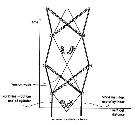

In the figures, the jagged lines are the effects from the frog collisions traveling down the length of the can. See in the top figure how they start when the frog hits that end and then through time go to the other end of the can, presumably at the speed of sound for the can’s material, which is very slow compared to the speed of light, and also probably slow compared to the relative speeds between the frame of the can and the other observer (I say this because the figures show significant relativistic effects and hence seem like the relative speed must be a meaningful fraction of the speed of light, which the speed of sound is not). I’ll explain the motion of the ends of the can in a comment to keep this shorter.
In the lower figure, the frogs travel faster toward the bottom of the can, but the tension wave from hitting the bottom then travels slower back to the top. No effect is seen on the center of the can until a tension wave gets there. The net forces on the center of the can never go above zero even in the moving frame. The tension waves cross there, canceling each other out (see figure)
In all frames, the effects from the two frogs reach the center of mass at the same time even though one frog hits first.

In the second frame, the pulses don't move through the medium at the same relative speed. So even though they don't begin simultaneously, they reach the center of the cylinder simultaneously. Neither pulse reaches the center before the other.
