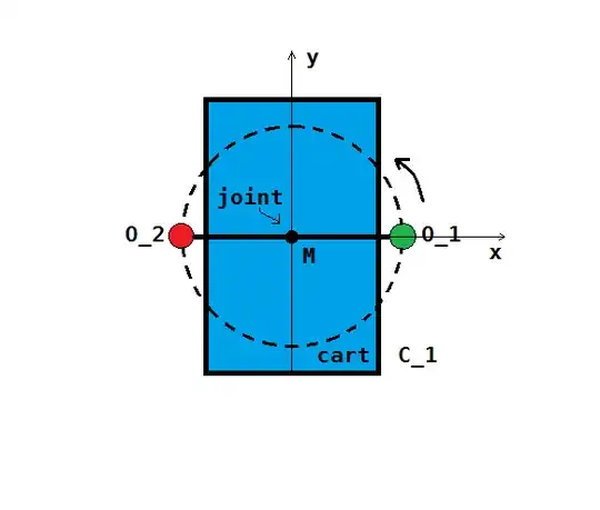

Consider two objects $O_1$ and $O_2$ of mass $m$ each. The objects are connected one to another with a rod of say length $2\cdot l$. At the middle of the rod, $M$, there is a rotational joint allowing the objects to rotate in a plane. The joint sits on a cart $C_1$ with the center of mass also at the point $M$.
Suppose the cart in the image above is restricted to move only up and down (that is on $y$ axis) and not allowed to rotate. Also suppose there are no other forces acting on the system but a torque applied to the bar, in the rotation joint such that the bar (along with the objects $O_1$ and $O_2$) are rotating with a constant angular velocity $\omega$ about the $z$ axis (coming out of screen).

I think the answer is yes if $E_x > 0$. For each of the objects during rotation the center of mass feels a centrifugal force $F = m\cdot l \cdot \omega^2$ in the direction of the object. However, because the cart is restricted to move only on $y$ axis the acceleration is given by the projection of this force on $y$ axis. Suppose $O_1$ is now on the upper half plane and let $\phi_1$ be the angle it forms with the $x$ axis. That means it has an extra energy, hence its inertial mass is $m_1 = m + \frac{E_x}{c^2}$. Therefore the force due to $O_1$ is $$ F_1 = \left( m + \frac{E_x}{c^2}\right)\cdot l\cdot \omega^2 \cdot \sin(\phi_1)$$ while the force due to $O_2$ (which is symmetric to $O_1$ about M) is $$ F_2 = - m\cdot l\cdot \omega^2 \cdot \sin(\phi_1) $$ Hence the total force felt by the cart is: $$F = F_1 + F_2 = \frac{E_x}{c^2} \cdot l\cdot \omega^2 \cdot \sin(\phi_1) > 0$$ for all $\phi_1 \in (0,\pi)$ Is this true?
PS: The linear momentum of the cart varies but no external force was applied to the center of mass ... ?! Therefore something might be wrong in my thinking, but I do not know what.

just before the object is moving out of the upper plane, pointing-downward momentum changes by $\frac{E_x}{c^2} l \omega$, since you are reducing its mass somehow while moving, and you are increasing the mass of the opposite mass will moving in the opposite direction. So your hypothetical mass shifting is also shifting momentum around

Sometimes assumptions simplify problems, but sometimes they appear to allow the laws of physics to be violated. You want to transfer energy via radiation, rather than matter, to get an "instantaneous" transfer. But the fastest that radiation can travel is c. In this case you still have to direct the radiation slightly in the y-direction in order for the receiving object to receive it, because the receiving object will travel a finite distance during energy transfer.
However, even if energy (via radiation or matter) could be transferred instantaneously, you argue that at the moment of transfer all changes of momentum are in the x-direction. This cannot be true. It's easier to see why if you consider the case of energy transfer via matter. For the object giving up energy, at the moment of transfer, a small amount of it's matter has to be decelerated to zero in the y-direction and accelerated (to infinity) in the x-direction. So some matter makes an instantaneous 90-degree turn. Whatever force causes the deceleration in the y-direction must come from the cart, through the rod, so the rod must undergo some bending stress. The resulting forces from the rod will have x and y components. This will be true when transferring energy via radiation as well, as alluded to in the above paragraph. So the cart must lose some momentum in the y direction during energy transfer.
Does this make sense?
