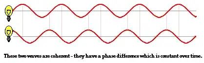

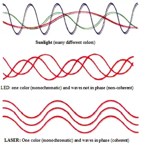

Also: I have found conflicting definitions of coherent light, where one definition is "constant phase difference" but another stating the waves must be all in-phase. I've attached two photos. The first photo shows that two waves are in phase as long as phase difference is constant. The second photo indicates that the waves must be in-phase in order for them to be coherent. Which is correct?

Coherence means waves which maintain the same phase difference between them as you mentioned. So the two waves in the first picture are coherent if they maintain the same phase difference. Note that this implies that they must have the same frequency.

The 2nd picture says that the waves are in phase so they are also coherent.
