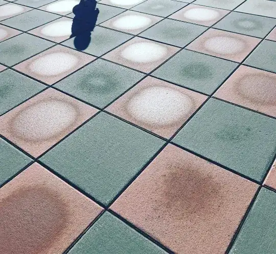

My friend's 3-year-old daughter asked "Why are there circles there?"
It had either rained the night before or frost had thawed. What explains the circles?
Follow-up question: Ideally, are these really circles or some kind of superellipse?

Both thawing and evaporation involve heat exchange between the stone tile, the water sitting atop the stone tile, any water that's been absorbed by the stone tile, and the air around. The basic reason that the center and the edges of the tile evaporate differently is that the gaps between the tiles change the way that heat is exchanged there. However the details of how that works are a little more involved than I can get into at the moment, and would be lost on a three-year-old anyway.
A good way to explain this phenomenon to a three-year-old would be to bake a batch of brownies in a square pan, and watch how the brownies get done from the outside of the pan inwards. Even after you have finished them you can still tell the difference between the super-crispy corner brownies, the medium-crispy edge brownies, and the gooey middle-of-the-pan brownies. The three-year-old would probably ask you to repeat this explanation many times.
I think the shapes are not exactly circles, superellipses, or any other simple mathematical object --- there's too much real life in the way --- but they do become more circular as the remaining puddle gets further from the edges.

According to @rob , "The basic reason that the center and the edges of the tile evaporate differently is that the gaps between the tiles change the way that heat is exchanged there. " This sounds reasonable. However, I'd like to offer some other tentative explanations. First of all, let me note that the tiles in the image look unglazed and, therefore, their surface is probably porous. So there maybe two additional explanations:
1) Pore distribution may depend on the distance from the edges due to peculiarities of the tile manufacturing process;
2) Tiles dry out faster near the edges because initially water there partially flows away to the gaps between the tiles, as the surface of the gaps is typically somewhat lower than the surface of the tiles.

The sides and corners of the cube are a few degrees warmer than the center.
They are there for the same reason that an ice-cube's corners go round, and the same reason that square stones lose their corners first in the river.
They aren't precisely circles, they are rounded squares also known as squircles. What would a child think of that word?
You can see from the shadow that the sun has warmed the upper left sides of the squares the fastest.
The corners and edges warm up first, especially the ones that catch the sunshine. The dark tiles are also hotter. (irradiance incidence and mathematics in W/m2 and mJ/m2 can perhaps be simplified into child concepts)
The water may also act as a solar reflector and reduce the surface area of the stone. Warmth from the ground may be escaping through the sides too.
The rain may have gathered more deeply towards the middle of the cube too, due to runoff dynamics and capillary action. Without sunshine, the capillary action would also thin the water from the edges and the corners faster than from the center.

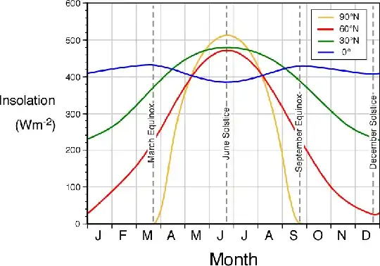

Information for adults rather than children: solar irradiation in W/m2, Paris is 47'N and Moscow is 55'N. enter image description here

Others have emphasised the effects of evaporation, but I'd suggest another key factor is likely to be related to several features of the grouting that make the edges dry sooner.
Firstly, the fact that the grout sits at a lower level from the top of the tile means moisture will tend to migrate to the lower level - and it will "drain" from the edges of the tile sooner than it drains from the middle of the tile.
Secondly, the grouting tends to be more porous than tile, and will absorb moisture more easily and conduct it away to drier areas due to capilliary action.
Thirdly, if the floor underneath is not sealed, then moisture will tend to migrate through the grout more quickly into the base and seep away, whereas the tile face is typically moisture-proof.
Another possibility is that there may be slight manufacturing imperfections in the planar surface of the tile, with a slight depression in their centre, which will tend to retain moisture against all the above factors.

I would suggest an alternative explanation: the tiles are not, in fact, perfectly flat.
"Flat" floor tiles actually have a degree of acceptable curvature when manufactured (similar to this list of deviations) which is small enough that it's not visible, and - as you will have doubtless observed in older tiles - tend to wear more at the centre over time, making them more concave. It is likely therefore that there is a small degree of curvature to the tiles you observed. This curvature is not marked enough to be directly visible, but enough that water will pool slightly more in the centre and run down the tile towards the centre as it evaporates from the edge.
While there are likely also thermodynamic differences, I think this is likely to have a bigger effect.
The grout betwen the tiles is dark, and has a rougher surface than the tile. (It's composed of sand, cement, and colorings.) It's also slightly lower than the tile surface. Therefore it collects solar heat better than the lighter colored tiles, and as the heat is conducted inwards to the tile, the frost melts/water evaporates.

Let's first observe the phenomenon more closely:
  • there is less or no water on the green tiles. It seems the brownish/reddish tiles have dried slower.
  • the perimeter of all tiles has dried faster than the centre.
  • the filling in the perimeter of the tiles (which is also between tiles) is darker than the tiles. In fact, the further a location is from the perimeter, the less chance that it is dry.
  • since frost was mentioned, it is probably winter or a cool time of the year. That is, the air is colder than ground temperature (ground temperature meaning at $1m$ depth and below).
Possible solutions:
Explaining the colour differential:
  • Darker colours absorb more wavelengths of light and heat, so they will get warmer under the same light or the same visible/near visible radiation. Some insights from this stackexchange and a good students' experiment on melting ice cubes on different colours here.
  • Accordingly, the green tiles are darker than the brownish reddish tiles, so they absorb more heat, making the water above them warmer, giving water molecules at the surface more energy, thus allowing them to escape in larger droves within a given time. The greener tiles thus dry faster.
  • The water on both types of tiles is equally reflective and transparent to light, so no difference expected from that aspect.
Explaining the perimeter/centre differential:
  • The filler material between the tiles looks darker and thus absorbs more light and heat, so that water at the perimeters evaporates more quickly.
  • The effect of the warmer perimeter diminishes as you move away from the line of the filler material between the tiles.
and furthermore...
  • Whilst the effect of colour is evidently stronger here, ground heat effect is likely not neutral. The ground is a large heat sink, so that parts of buildings that are at ground level or below ground level are less affected by air temperature variation during the year, tending to be more temperature-stable. This phenomenon makes geothermal heat pumps practical alternatives to air conditioning using the refrigeration cycle.
  • If the tiles conduct heat better than the perimeter filler material, then the ground heat effect is reducing the (surface colour-driven) contrast between the perimeter and the centre of the tiles since more heat is conducted upwards through the centre of the tiles than through the perimeter.
  • If the filler material is a better conductor of heat however, the ground heat effect exaggerates the phenomenon of 'round' patches to some degree.

In the most straight forward and basic terms..
Water that resides close to a side face of the tile (near the cracks) will exit the tile in both a horizontal and vertical fashion, thus allowing a quicker rate of drying within those regions of the tile's volume. The water in the middle, however, only leaves the tile vertically.
And then, as @rob mentioned, neighboring tiles also assist in heating each other, so, there's a kind of compounding effect when considering multiple and closely adjacent tiles; or, at least, initially there is.
Lastly, keep in mind that the color of the tile also plays a major role in the overall evaporation rate. As you can see, green tiles have evaporated most quickly, with red lagging behind, and this is to be expected. If these tiles weren't uniform in color, and, oriented in such an alternating fashion, you probably wouldn't have observed such circular shapes for the remaining moisture.

Have you checked whether the tiles are really completely flat? The easiest explanation would be that in the middle of the tiles the water is a little deeper than at the outside and that the water evaporation starting in the shallower outside parts causes these quasi-circular water puddles. You could easily test this by pouring some water on a dry tile and then see whether a puddle forms in the middle.
