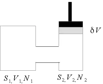

Consider the system as shown in the picture. It consists of two chambers filled with a gas and connected with a tube. One chamber is closed with a piston. Everything is thermally insulated.
We make two assumptions:
  • The total amount of gas is constant;
  • The connecting tube is such that the pressure in both chambers gets equilibrated.
The initial state is such that the pressures are equal, i.e., $p_1=p_2$ and the temperatures are different: $T_1\neq T_2$.
Let the piston move s.t. the volume in the second chamber changes by $\delta V$. So, we have (here the prime $'$ denotes the state after the transition)
$$V_1'=V_1,\, V_2'=V_2+\delta V,\, N_1'=N_1+\delta N,\, N_2'=N_2-\delta N,$$ and $\delta N$ is determined from the condition $p_1=p_2=p$.
So, my question is
How to describe the change in entropy: $S_1'=?, S_2'=?$
Let $S_1'=S_1+\delta S_1, S_2'=S_2+\delta S_2$. We can compute the change in total energy: $$(U_1'+U_2')-(U_1+U_2)=T_1\delta S_1 +\mu_1\delta N + T_2\delta S_2 -p\delta V -\mu_2\delta N,$$ which is equal to work done on the system, $\Delta W=-p\delta V$. So, we conclude that it must hold that $$0=T_1\delta S_1 +\mu_1\delta N + T_2\delta S_2 -\mu_2\delta N.$$ The terms $\delta S_1$ and $\delta S_2$ should satisfy this equality. However, I'm still not clear what would be the exact form of these terms. I tried several options, but couldn't convince myself.

What we are dealing with here is an irreversible process, where some of the gas from chamber 2 at temperature $T_2$ flows through the intervening tube and mixes with the gas already present in chamber 1 at temperature $T_1$. This mixing gives rise to irreversibility present in the process. Accordingly, to establish the entropy change for this irreversible process, we must follow the standard procedure of first employing the first law of thermodynamics to establish the final state of the system, and then determining the entropy difference between the initial and final states. (Without establishing the final state of the system, it is not possible to determine the entropy change)
Were are told that at each stage of this process, the pressures within the two chambers are equal. This enables us to establish relationships for the number of moles in each chamber and for the pressure. Let the total number of moles in the two chambers be N, and let the initial number of moles in each chamber be $N_{10}$ and $N_{20}$. And let then number of moles in the two chamber at any other stage of the process be $N_1$ and $N_2$, such that $$N_1+N_2=N_{10}+N_{20}=N\tag{1}$$The condition of equal pressure in the two chambers requires that $$\frac{N_1T_1}{V_1}=\frac{N_2T_2}{V_2}\tag{2}$$If we combine Eqns. 1 and 2, we obtain: $$N_1=\frac{V_1T_2}{(V_1T_2+V_2T_1)}N\tag{3a}$$and$$N_2=\frac{V_2T_1}{(V_1T_2+V_2T_1)}N\tag{3b}$$ And, for the pressure, we obtain: $$P=\frac{NRT_1T_2}{(V_1T_2+V_2T_1)}\tag{4}$$
Since each of the chambers is an open system, with gas flowing in or out, we must use the open system (control volume) version of the first law of thermodynamics to describe the energy balances. For chambers 1 and 2, these read respectively:
$$d(N_1u_1)=h_2dN_1\tag{5a}$$ $$d(N_2u_2)=h_2dN_2-PdV_2\tag{5b}$$where u and h represent internal energy and enthalpy per mole of gas. The terms $h_2dN_1$ and $h_2dN_2$ in these equations represent enthalpy flow from chamber 2 into chamber 1 and enthalpy flow out of chamber 2, respectively. If we combine Eqns. 3-5, we obtain two equations in two unknowns for the changes in $T_1$ and $T_2$ as functions of the changes in $V_2$.
Let us first work with Eqn. 5b. If we apply the product rule to the left hand side of this equation, we obtain: $$N_2du_2=(h_2-u_2)dN_2-PdV_2\tag{6}$$But, for an ideal gas, we have: $du_2=C_vdT_2$, $h_2-u_2=RT_2$, and $P=N_2RT_2/V_2$; making these substitutions into Eqn. 6 yields: $$N_2C_vdT_2=RT_2dN_2-\frac{N_2RT_2}{V_2}dV_2\tag{7}$$Dividing this equation by $N_2T_2$yields an exact differential: $$d\ln{\left[T_2\left(\frac{V_2}{N_2}\right)^{R/C_v}\right]}=0\tag{8}$$or, combining this with Eqn. 3b yields:$$T_2\left(\frac{V_1T_2+V_2T_1}{T_1}\right)^{R/C_v}=T_{20}\left(\frac{V_1T_{20}+V_{20}T_{10}}{T_{10}}\right)^{R/C_v}\tag{9}$$
Once $V_2$ is specified, the only unknowns in Eqn. 9 are $T_1$ and $T_2$. Another equation relating these unknowns is provided by Eqn. 5a, the first law open system energy balance on chamber 1. Unfortunately, I have not been able to arrive at an analytic integration of this equation the way I have for Eqn. 5b. However, I will report on what I have obtained so far.
If we employ ideal gas relationships to Eqn. 5a similar to those used for Eqn. 5b, we obtain: $$C_vdT_1=[C_v(T_2-T_2)+RT_2]d\ln{N_1}\tag{10a}$$with $$d\ln{N_1}=d\ln{\left(\frac{T_2}{V_1T_2+V_2T_1}\right)}\tag{10b}$$
Maybe someone else can figure out a way of analytically integrating Eqns. 10, subject to Eqns. 9 to obtain $T_1$ and $T_2$ as functions of $V_2$. So far this has eluded me. As noted previously, we need to obtain these functional relationships in order to determine the change in entropy of the system as a unique function of $V_2$. In practice, if I could not carry out the integration of the equations analytically, I would resort to numerical integration.
ADDENDUM I did some additional analysis on this problem and was able to simplify Eqns. 10 by combining them with Eqn. 9 to obtain: $$\frac{dT_1}{dT_2}=\frac{C_v}{R}\frac{T_1}{T_2}\left(\frac{C_p}{C_v}-\frac{T_1}{T_2}\right)\tag{11}$$Note that this equation no longer contains the volumes, and thus describes how $T_1$ must vary in tandem with $T_2$, starting with specified initial values of these parameters, for any arbitrary variation in $V_2$.

I've finally been successful in integrating Eqn. 11 analytically to obtain $T_1$ as an explicit function of $T_2$. The result is:
$$T_1=\frac{T_2}{\left[1+\left(\frac{T_{20}}{T_{10}}-1\right)\left(\frac{T_{20}}{T_2}\right)^{C_v/R}\right]}\tag{11a}$$ Note from this that, as would be expected, if $T_{10}=T_{20}$, $T_1=T_2$
CHANGE IN ENTROPY
The change in entropy for this system is given by: $$\Delta S=(N_1s_1+N_2s_2)-(N_{10}s_{10}+N_{20}s_{20})\tag{12}$$ where the s's are molar entropies:
$$s=C_v\ln{(T/T_{ref})}+R\ln{(v/v_{ref})}\tag{13}$$where $T_{ref}$ and $v_{ref}$ are the temperature and molar volume at some arbitrary reference state; these parameters cancel out of the calculations. The specific volume $v_j$ for chamber j is given by $v_j=V_j/N_j$.
ADDITIONAL ANALYSIS ON 3/5/18
Intuitively, and, based on Eqns. 8 and 9 of the present analysis, we know that the gas remaining in chamber 2 at any time during this process has experienced an adiabatic reversible compression, such that its final entropy per unit mass is equal to its initial entropy per unit mass: $$s_2=s_{20}$$If we substitute this into Eqn. 12, this yields:
$$\Delta S=N_1s_1-N_{10}s_{10}-(N_{20}-N_2)s_{20}\tag{14}$$
Unfortunately, the same kind of simplification can not be made for chamber 1. However, further simplification is possible in the following way: We can substitute the identity $N_1=N_{10}+(N_1-N_{10}$ Into Eqn. 14 to obtain: $$\Delta S=N_{10}(s_1-s_{10})+(N_1-N_{10})s_1-(N_{20}-N_2)s_2\tag{15}$$But, from the material balance, we have, $$(N_1-N_{10})=(N_{20}-N_2)$$Substituting this into equation 15 then yields: $$\Delta S=N_{10}(s_1-s_{10})-(N_{20}-N_2)(s_2-s_1)\tag{16}$$But, since the pressures are equal in chambers 1 and 2, the term $(s_2-s_1)$ is just: $(s_2-s_1)=C_p\ln{(T_2/T_1)}$. Therefore, Eqn. 16 becomes: $$\Delta S=N_{10}(s_1-s_{10})-(N_{20}-N_2)C_p\ln{(T_2/T_1)}\tag{17}$$

The total entropy of the two volume $S=S_1+S_2$ . The entropy will not change because it is insulated, $\Delta Q=0$. In the other word, assuming the piston moves really slow, $\Delta S = 0$ or $S_1+S_2 =0$.
We know that volume 1 received gas from volume 2 at different temperature. When it receives gas, its entropy increases. And from the above equation, the entropy of volume 2 will decrease.
I guess I need to use this equation to do the work.
$$dS = \frac{dU}T+\frac PTdV-\frac{\mu}TdN$$
If there is no piston motion, the above equation becomes
$$dS = \frac{dU}T-\frac{\mu}TdN$$
Initially, there is no flow between the two volumes because the pressures equal to each other. Thus, $dN=0$.
The above process has heat transfer through the pipe. Therefore, the internal energy changes. Assuming $T_1>T_2$, then $U_1$ decreases and $U_2$ increases with the same amount. The entropies change accordingly. Because of the temperature difference, the entropy changes are different. (So I was wrong saying that the total entropy is constant. It should be $dQ(-\frac 1 {T_1} + \frac 1 {T_2})$, where dQ is the amount of heat transferred from volume 1 to volume 2.)
Now back to the original question. Let's use the following equation again for volume 1 and volume 2.
For volume 1,
$$dS_1 = \frac{dU_1}{T_1}-\frac{\mu_1}{T_2}dN_1$$
And for volume 2,
$$dS_2 = \frac{dU_2}{T_2}+\frac {P_2}{T_2}dV_2-\frac{\mu_2}{T_2}dN_2$$
So we know that $dN_1=-dN_2$ and $dN_1>0$ because the flow is from volume 2 to volume 1. This will reduce $S1$ and increase $S_2$.
We also know that $dV_2<0$, which will reduce $S_2$.
On the internal energy change, it is complicated and depends on $T_1$ and $T_2$. Using an iterative method and equation of state, we may get final pressure and temperature. But so far, I would say the problem is undetermined.
