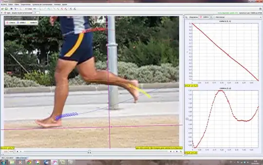

But since the quick answer is obviously not all that evident, lets do it also the long way... The running gait has several distinct phases to it. Simplifying things to the maximum, there is a stance phase, while the foot is on the ground, and a flight phase, where the runner is basically in parabolic motion. During the stance, the legs recoil to drive you up again, but the horizontal velocity remains relatively constant. The image below shows a still of a video analysis of my own running gait I did using tracker. The graphs on the right are the x-t and y-t graphs for my hip, which is pretty close to the COM. There are many subtleties that can be taken into account, but this sort of supports the claim that horizontal speed is roughly constant throughout, and there is a parabolic flight phase.
To keep running you have to keep yourself hopping up and down. Ideally most of the upward push comes from recoil from the tendons, and all force is done in the vertical direction, so that the horizontal speed does stay constant.
