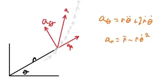

There are two axis where velocity and acceleration travel in a theta pulls a particle to the center of the curve just like the normal acceleration in a car pull you into the curve. Ar in the picture really changes the direction. The angular velocity should be on the axis of rotation because the axis are all arbitrary and you can make them where it is easiest to solve.
I hoped that helped
