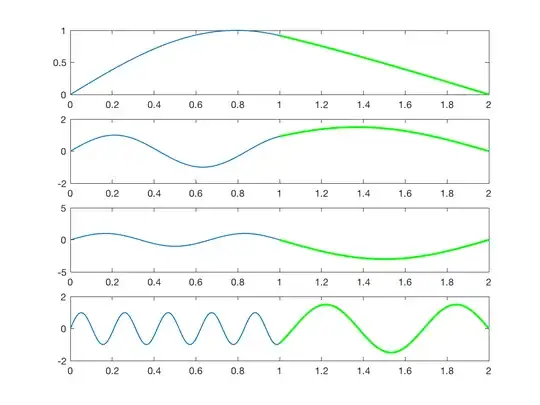

Here are plots of 4 different harmonics calculated from the above:
Interestingly, for the trivial mode where there is a node at the junction, the ratio of amplitudes of the waves needed for continuity is different (3:1 vs 1.5 : 1). Not sure why that is.

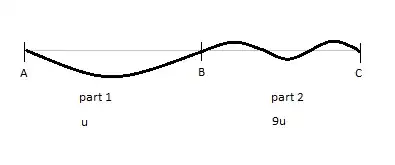

To keep things simple, let's start with:
Let's assume that I observe standing waves at a frequency $f1,f2,f3$... what would be the shape of the string. It can't be simple one loop,two loops, three loops respectively, as the wavelength of the wave changes when we go from one side to the other.
The velocity of wave in a string is given by $ v = \sqrt{\frac T\mu} $ where $T$ is tension in string and $\mu $ is mass per unit length of string.
Since second part is nine times as dense than the first part, and tension in both strings is same, clearly,$$ v_1 = 3v_2$$
So wavelengths in the parts will be related as $\lambda_1 = 3\lambda_2$ as frequency of the wave will remain the same throughout the string. So the string, in its fundamental frequency, will look something like: enter image description here
For higher frequencies, just multiply the number of half-wavelengths between $AB$ and $BC$ at fundamental frequency by the level of harmonic to get the number of half-wavelengths at the $n^{th}$ harmonic.
Now let's look at this:
For standing waves to be formed does the $W_1$ need to be in phase with the initial wave or does the $W_2$ need to be in phase with the initial wave.
For fundamental standing wave, $W_2$ will be in phase with initial wave when it first meets the junction. $W_1$ won't be in phase with initial wave after the first reflection. But that will change after subsequent reflections/transmissions.
(By being in phase I mean they will oscillate on the same side of the string, and I assume you meant the same)
This is because $W_1$ will undergo a $\pi$ shift in phase when reflected at junction $B$. Also, by the time $W_2$ will travel from B to C and back to B, $W_1$ will have traveled from B to A and back three times. The $W_2$ reflected at C will undergo $\pi$ shift, and hence when it enters the first part at B, it will be in phase with the initial wave.
