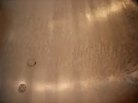

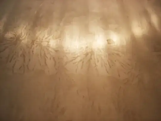

I noticed tree-like patterns on inner surfaces of home appliances plastic bodies. For example, on the lid of air conditioner indoor unit, inside of humidifier, at the bottom of washing machine powder drawer. The shape of the patterns reminds of Lichtenberg figures, but there's no source of high voltage inside those machines and no obvious reason of forming a high electric charge on the surface (and I've never been hit by a spark from them).
The following pictures demonstrate some of the patterns I found. The "branches" are near 1 mm wide. Contrast was increased a little. Tree-like pattern example 1 Tree-like pattern example 2 The patterns can be easily washed away with soap and water, they are probably formed of dust. Air indoors is moderately humid in summer and very dry in winter, if it's important.
What is the reason of those patterns and what do they consist of?
