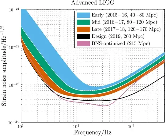

  • You very often see the unit $\mathrm{Hz}^{-1/2}$ in any field that requires signal analysis in any capacity, where it comes out naturally as a way to describe amplitude spectral densities of many kinds. This happens when you have some signal $f(t)$ (in, say, dimensionless strain) and you care about its Fourier transform, i.e. you want to represent $f(t) = \int_{-\infty}^\infty \tilde f(\omega) e^{-i\omega t} \mathrm d\omega$ in such a way that $\int_{\omega_1}^{\omega_2} |\tilde f(\omega)|^2 \mathrm d\omega$ represents the power the signal carries in that spectral band.
    A nice, recent example of this in action is the noise sensitivity curves for LIGO and other gravitational-wave detectors as a function of frequency:
    Image source
