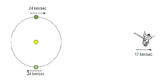

When I read JPL's mission status for Voyager 1 and Voyager 2 the distance between Earth and Voyager 1 is decreasing.
Is it right?
Jin Kwon
  • 361
82
Voyager $1$ is headed away from the Sun at around $17$ km per second at an angle to the ecliptic of around $35$º.
The orbital velocity of the Earth is $29.8$ km per second, and multiplying by $\cos 35$º to get the component of the velocity in Voyager's direction gives a shade over $24$ km per second.
So at the point in its orbit where Earth is moving closest to the direction of Voyager's travel we are actually catching up with it at around $24 - 17 = 7$ km per second. Conversely at the point in Earth's orbit where it is moving opposite to Voyager it is moving away from us at $24 + 17 = 41$ km per second.
Voyager relative speed
(not to scale!)
