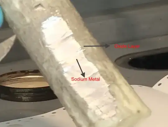

Any reactive metal would not exist in nature in its elemental state. So, these metals get oxidised by oxygen present in the air. This makes an oxide layer on their surface. Due to this layer, metals loose their lustre. This layer protects the inner metal from further oxidation or reaction. But if you remove this layer, you can see the lustrous metal again.
So most of the metals that you see aren't really pure. They either exist as oxides or salts. There are unreactive metals like Gold (Work function 5.10$eV$ – 5.47$eV$) which exist in pure metallic state but their work function is quite high compared to highly reactive metals like Caesium (Work function 1.95$eV$).

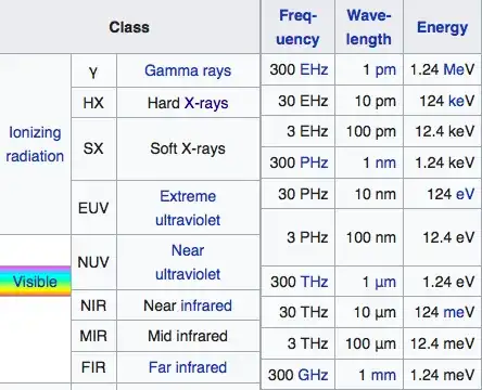

Light, some infrared, some ultraviolet, and microwaves, pass through the atmosphere and reach the Earth's surface. Gamma rays, X-rays, most of the ultraviolet and some of the infrared are absorbed by the atmosphere and do not reach the Earth's surface. Most of the high energy radiation that is capable of causing photoemission doesn't even reach the Earth's surface.
