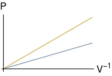

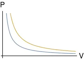

As you stated, Boyle's law says that $PV=k_1$ at constant temperature. This can be written as $$ P=\frac{k_1}{V}=k_1\,(V^{-1})\tag{1}$$ Thus, the plot of $P$ vs. $V^{-1}$ is a straight line with slope $k_1$. Moreover, it is also common to present the Boyle's law as a graph of $P$ and $V$. This means that, considering Eq. $(1)$, plotting $P$ vs. $V$ is like plotting a $y(x)=cx^{-1}$, and this is not a straight line. Examples for a gas at different temperatures are below, being the orange line at higher $T$:

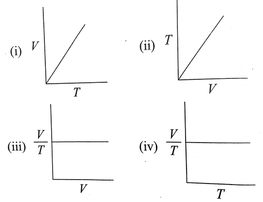

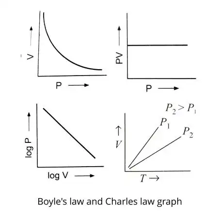

The graphs below shows three conventional ways of graphically presenting Boyle's law. As observed from the graphs below, the pressure increases with a decrease in volume, and vice versa. Pressure is inversely proportional to volume, so other parameters (temperature and amount of gas) are constant.
Charles's law states that the volume of a gas increases with the temperature, and vice versa. The graphs below shows four conventional ways of graphically presenting Charles's law. Volume is directly proportional to temperature at a constant pressure,
