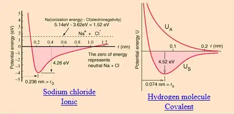

All bound systems can be to first order approximated to a potential well, classically and quantum mechanically.
Water in a reservoir has high potential gravitational energy, potential in this case means "it is possible to get this much energy if the water reaches the ground"
Quantum mechanically the meanings do not change , and chemical bonds are in the realm of quantum mechanics, but the reasoning for the definition of potential is the same: there exists a lower energy state, a ground state.

Atoms and molecules release energy and settle at the lowest ground state of the potential in question.
'potential energy' only the ability to release energy due to its position etc,
Yes, as shown above. Once bonded, energy has to be supplied so that the "free" state (ionization state) can be achieved.
