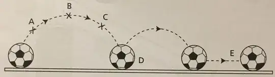

I'm going through physics with my 5th grade child. There is a question and answer that indicates that a airborne ball at the top of the trajectory does not have kinetic energy.
  1. The diagram below shows the path taken by a ball after it was kicked. The ball hit the ground initially at D and eventually stopped moving at E.
    image of ball bouncing with several points on the path labeled
    At which position(s) did the ball have no kinetic energy?
    1. B only
    2. A and E only
    3. B and E only
    4. B, D, and E only
This is the explanation given in the book:
  1. Answer: 3. B and E only
    • At A and C, the ball had both kinetic energy and (gravitational) potential energy.
    • At the maximum height at B, the ball had only (gravitational) potential energy but no kinetic energy.
    • At D, the ball had kinetic energy but no (gravitational) potential energy as it was at the ground level.
    • At E, the ball stopped moving, so it had no kinetic energy. The ball also had not (gravitationa) potential energy as it was at ground level.
Ignoring the "complicated" fact that anything with heat has kinetic energy internally, is there some reason the ball wouldn't continue to have kinetic energy? There is no longer vertical motion, but it is still in forward motion.

The answer is wrong. Some author confused the situation when the ball is moving only vertically (and a graph as a function of time) with this case where there is horizontal motion. The horizontal component of the velocity is constant in a ballistic trajectory, it is the same at points A, B, and C.
The kinetic energy is zero only when the ball is stationary, and the ball is stationary only at E: so this is the only point where the kinetic energy is zero.
So... do not trust this book.

The book text is wrong.
If it has kinetic energy at D then it has kinetic energy at B.
There is component of motion in the X direction.
At D there is the potential energy of compressed air (what makes it bounce).
The correct answer E is not even a choice in the book.

Over much deliberation, I agree with Pieter's answer. Perhaps I shall elaborate more. The equation of kinetic energy is $\frac{1}{2}mv^2$. The motion of the ball is a projectile motion, and can be resolved by 2 vectors: the horizontal and the vertical.
The vertical component of this velocity decreases by $-g$ as it approaches the maximum height. Hence, it's velocity at the maximum height is zero, as the energy over here has become potential energy.
The horizontal component, on the other hand, is not zero, and keeps on decreasing, as energy is lost via heat energy.
Hence, our resultant velocity is not zero. Hence $\frac{1}{2}mv^2$ is definitely not zero. Hence, only E, when the ball is at rest, is correct.

First, the picture is really misleading. When I look at it, I seems to indicate that the ball is still moving horizontally, and therefore it has kinetic energy at point B. It wouldn't have kinetic energy at the top only if you throw the ball absolutely straight upwards.
It gets worse. Assuming that the horizontal movement of the drawing just represents a time line and the ball is actually going straight up and down, the answer for point D is very, very dubious. When the ball hits the ground, it starts with kinetic energy due to moving downwards. That energy is converted into potential energy (like a spring) when the ball hits the ground and gets compressed. At the point of maximum compression there is no kinetic energy, the ball stands still. Then it starts expanding again, and the potential energy is again turned into kinetic energy.
As other have stated, the only state where it has no kinetic energy is E, UNLESS the ball is considered to only move in the vertical direction (in which case, the ball has no kinetic energy at B).
As for potential (gravity) energy, if considering the ground as the "absolute" level 0, then it has none, but, obviously, if someone was to dig a hole under the ball, it would fall... which indicates that it DOES have potential energy (but that the energy cannot be converted, as the ball cannot fall), rather than having none at all. However, this "approximation" is being used by most physicists, so we can let it slide.
All in all, the book seems to be garbage in the way it explains things, even if the author seems to know what he's talking about. Better dump it in the trash bin, and look for a better one.

If the ball is moving it has kinetic energy. If the ball were kicked straight up, at the apogee its energy would be all potential since it's not moving horizontally or vertically, it stops momentarily. If the ball is kicked in any direction except perfectly vertical, it has kinetic energy throughout its flight since it never stops moving horizontally. The potential energy at any point in its path is gh, where h is how high from a reference, the ground in this case, the ball is at any given time and g, gravity. When the ball is on the ground, PE is zero.
Of course, gravitational potential energy is the kind we're considering vs. stored energy from the kick or bounces.
Yeah, that book stinks!

As others have mentioned, the question and answer as written is flawed. The correct answer is of course E Only.
However there is one condition where B could have zero kinetic energy.
That would be if the frame of reference is moving at exactly the same speed as the ball is moving when at the top of the first peak.
That is, if the entire thing above is inside a railway car that accelerates right to that exact speed as the ball reaches B, and you are watching from inside the car.
If the train car then decelerated back to the initial velocity after the ball passed B and reaches E, I guess B and E is possible.
Mind you, the curve for the first loop would look significantly contracted.
Bonus Point: The soccer ball needs air if it bounced like that, or the floor is made of jello.
