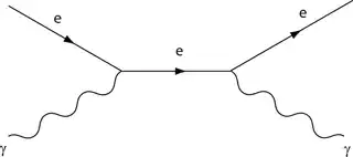

Electrons interact with the incoming photons of the beam in Feynman diagrams of the type :
thomson
A Feynman diagram representing the γe→γe process. In the classical limit, this is called Thomson scattering. The quantum version is called Compton scattering, and in the relativistic regime, the result is given by the Klein-Nishina formula.
Collectively the superposition of the individual interactions will build up the observed classical behavior , which is given by the $ψ*ψ$ of the whole ensemble. It is evident, that since the classical descriptions are so successful , the classical solutions are used for most electromagnetic interactions. The quantum mechanical calculations are reserved for few particle interactions and high energy photons.
