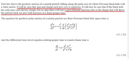

In the case of black holes that are rotating and charged, a repulsive potential is generated inside, which throws the bodies that have fallen below the event horizon backwards, out of the horizon. On certain orbits and with certain energies. enter image description here
https://www.oocities.org/zcphysicsms/
