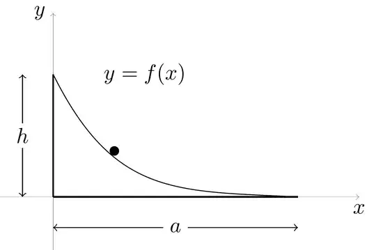

Let me expand on Ben's answer by giving a quantitative argument.
Particle sliding on a frictionless hill.
Let $x$ be the horizontal coordinate and $y$ the vertical one, such that, for instance, the gravitational acceleration is $\mathbf g=-g \mathbf{\hat y}$. We consider a profile $y=f(x)$ for a frictionless hill, where a point particle of unit mass is constrained to move. The function $f(x)$ is such that (letting $a$ be the base of the hill) $$ f(0)=h\,,\qquad f(a)=0\,,\qquad f'(a)=0 $$ and $h$ is the maximum of $f$ in the interval $[0,a]$. The gravitational potential energy is $U(y)=g y$.
$\bullet$ In a reference system which is stationary with respect to the hill, the trajectory $\mathbf r(t)=(x(t),y(t))$ of a point particle constrained to its surface satisfies: $$ \begin{aligned} y(t)-f(x(t))&=0\\ \dot y - f' \dot x&=0\\ \ddot y - f' \ddot x - f'' \dot x^2&=0\,. \end{aligned} $$ In particular, by the second equation, the trajectory is always tangent to the surface, whose unit normal to the constraint is $\mathbf n =(n_x, n_y)$ $$ n_x=\frac{-f'}{\sqrt{1+f'^2}}\,,\qquad n_y=\frac{1}{\sqrt{1+f'^2}}. $$ Namely, $$ \mathbf n \cdot \dot{\mathbf{r}}=0 $$ The Newton equation reads $$ \ddot{\mathbf{r}}=-g \mathbf{\hat y} + R \mathbf n $$ where $\mathbf R=R \mathbf n$ is the reaction of the constraint, and it is normal to it because the hill is frictionless. Then, multiplying by $\dot{\mathbf{r}}$, we get te usual conservation of mechanical energy $E$ $$ \dot E(t)=\frac{d}{dt}\left(\frac{1}{2}\dot{\mathbf{r}}^2+gy\right)=R \mathbf n\cdot \dot{\mathbf r}=0\,. $$ If the particle starts with zero velocity, the energy balance $E_0=g h=\frac{1}{2}v^2$ gives $v=\sqrt{2gh}$ for the final velocity.
$\bullet$ If now we choose a reference system which moves with respect to the previous one, with a constant velocity $-u \mathbf{\hat{x}}$, the previous equations get modified as follows. $$ \begin{aligned} y(t)-f(x(t)-ut)&=0\\ \dot y - f' (\dot x-u)&=0\\ \ddot y - f' \ddot x - f'' (\dot x-u)^2&=0\,. \end{aligned} $$ So, $$ \dot E(t)= R \mathbf n \cdot \dot{\mathbf{x}}=-\frac{u f'}{1+f'^2}(g+(\dot x-u)^2 f'')\,. $$ This equation can be integrated by employing the conservation of energy in the stationary frame, since $x-ut$ is indeed the trajectory in that frame by Galileian invariance: $$ dt = \sqrt{\frac{1+f'^2(x)}{2(E_0-U(f(x)))}} dx\,,\qquad \dot x^2=\frac{2(E_0-U(f(x))}{1+f'^2(x)}\,. $$ The result is $$ E(t)=E(0)+u\sqrt{\frac{2(E_0-U(f(x)))}{1+f'^2(x)}}\,\Bigg|_0^a\,. $$ Since $E_0=gh$, $f'(a)=0$ and $U(f(x))=g f(x)$, we finally find $$ E(t)=E(0)+u\sqrt{2gh}\,. $$ Imposing this with an initial velocity $u\mathbf{\hat{x}}$ and a final velocity $(u+v')\mathbf{\hat{x}}$, in the moving frame, yields $$ \frac{1}{2}(u+v')^2=\frac{1}{2}u^2+g h + u \sqrt{2 g h} $$ and this is solved by $v'=\sqrt{2gh}=v$, as desired.
