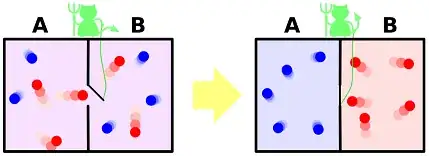

You could harness heat with near-perfect efficiency! Just requires finding Maxwell's demon. Maxwell's demon can be tough to find, but Laplace's demon could tell ya where it's at.
The fun thing about Maxwell's demon is that it likes to separate stuff out based on its highly precise perception and movement:
So, you basically tell Maxwell's demon to let out high-speed particles when they're at nearly-tangential velocities to power a dynamo. And, bam! Electricity.

In real life, there's interest in creating molecular machines, like observed in the classical example of ATP synthase, as a future technology. As @J... pointed out, Maxwell's demon in the above is acting as a thermal rectifier which are currently being researched (example).
