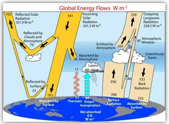

The answer is "No", and here is the qualitative explanation. The Greenhouse Effect is not about extra energy input at the Earth's surface, nor is it about reducing the thermal output. It is about upwelling.
In the static, ocean-free black body model: consider and sensor in deep space looking back at Earth black-body radiating in the infrared: it does not see the surface, it sees 1-optical depth depth down into the atmosphere, and it is that chunk of atmosphere that is at the correct blackbody temperature to balance the energy input. As you penetrate more optical depths into the atmosphere, it gets hotter, down to the surface, where it's hottest.
So the surface is hottest, radiating isotropically, with energy transfer to cooler regions above, which do the same, and so on. The processes are refer to as upwelling and radiative transfer.
The addition of greenhouse gases increase the optical of the atmosphere, thereby raising the surface temperature without changing the energy input or output.

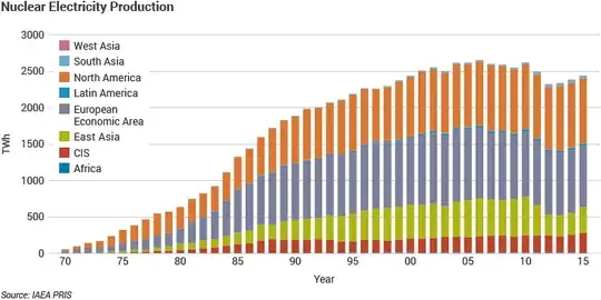

Nuclear amounts to =0,005 W/m2, most of it is not thermal, it's light, fridges and mechanical drives.
A change of CO2 from 280ppmv to 410ppmv traps about 2 W/m2.
Greenhouse effect is 1000 - 2000 times more warming for the planet than nuclear. The thermal efficiency of a conventional nuclear power station is around 33%, gas turbine ones are at 60%. Decay efficiency of the waste is nearly zero.
In environmental sciences, they measure Global Economic Systems of energy and chemistry:
All the nuclear before Fukushima did 2500,000 GW/h. it's 11 percent of human energy needs.
the earth has 510.1 million KM2, mult by 1mn to have the number in meters.
2500,000,000,000Wh / 510,000,000,000,000 m2 = 2500 / 510,000 =0,005 W/m2
the sun gives us 10,000 times more than all the energy we make, and our energy is used mostly for used for machine drives, TV, communications and lighting.
